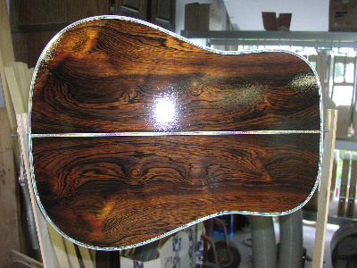

Very pretty John...nicely done. I didnt see the back is it EIR?
The only thing that would have been more over the top would have been if it was BRW to match that Adirondack.

It is BRW and it is old. Thanks agian
